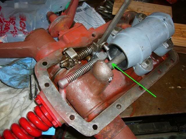

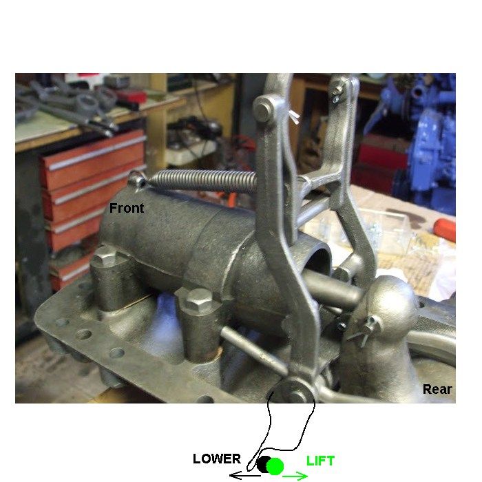

Since you have no responses, I will offer a suggestion that may answer your question. Which of these pictures looks like the control arm(s) on your top cover? If like the first, then you pump will not work with the standard 8N cover/control arm mechanism shown in second picture.
