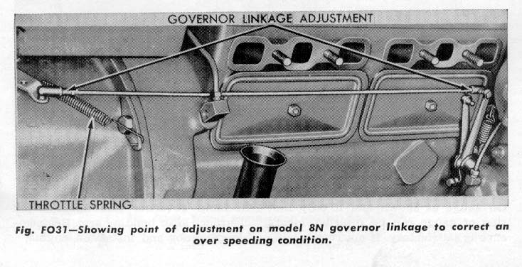

Jeff, is your linkage connected like the pic below? Have you adjusted the length of the long linkage rod?
Hope this helps............Ed
